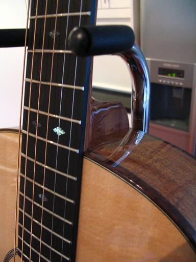

I've just noticed your fretboard ,which looks deliciously wide . What are it's dimensions ?
Looks to be an ideal fingerstyle guitar , and as you say , perfect for a couch session.
It really is stunning !
Regards , Kiwi
CRAIG LAWRENCE of AUSTRALIA
PostPosted: Wed Nov 29, 2006 10:29 am
Hi Kiwi, yes it is pretty wide, don't remember the exact dimensions off hand, I'll have to have a look at my drawings when I get home. It is a bit over 1 7/8" at the nut. It was a bit of an experiment, I figured a shorter scale would bring the frets closer together so stretching would be a little easier, and the strings a bit further apart might make playing a bit easier with my big clumsy fingers. With my lousy playing I need all the help I can get.
I did build this as a fingerstyle guitar. I also spent a lot of time thinking about the wood combinations, I was after some earthy tones without much if any contrast between back/sides and binding.
This guitar fought me every step of the way. I ruined one top, managed to save the abalone rosette and re-use it. I also destroyed one half finished neck. Had the router in the router table shaping the headstock, next thing I know the neck's been ripped out of my hands and thrown across the workshop, split the headstock down the middle. That neck was an experiment too, made it out of Narra. Live and learn. I just hope the next guitar goes together a little more smoothly.

Paul, that is a fantastic looking instrument!
Gorgeous finish... Hmmm... too bad we can't lay our hands on that stuff over here... Like nitro, tuff like poly and easy to apply as FP!
Did you rub this stuff on? Spray?
Keep up the awesome work!
PostPosted: Wed Nov 29, 2006 12:31 pm
Thanks Alain, it was a bit of both really. I started out french polishing, but it was taking too long - I'm not very good at FP. I was once an industrial spray painter. so I put away the muneca and went shopping for a spray gun seeing as my wife and daughter had bought me a compressor for fathers day. I gave it two fairly thick coats with the spray gun, I used the hard shellac neat straight out of the bottle.
There were a few very small places where I'd rubbed through the finish while levelling so I pulled out the muneca and touched it up FP style. I love this stuff

Wow Paul... No kidding, that stuff seems very forgiving... Hard Shellac... I think I'm in love!
Thanks for the info!

You have excelled my friend, that little guitar is just stunning. That dark blackwood is simply superb as is the silk in that top. The tiger myrtle bindings ties it all together so very well.
For what its worth from me, full marks for wood combination, full marks for skill in construction and full marks for the incredible finish.
Plus a huge thanks to both Craig and yourself for bringing Hard Shellac to my attention, what can I say but, "U-Beaut" .
